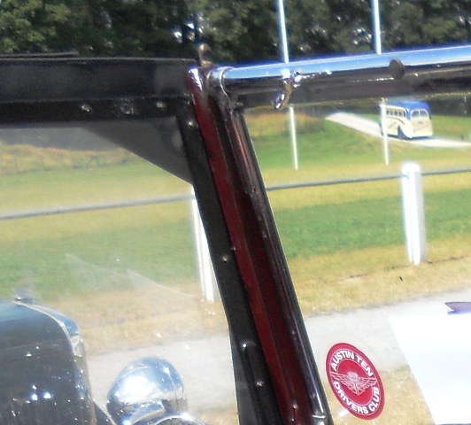

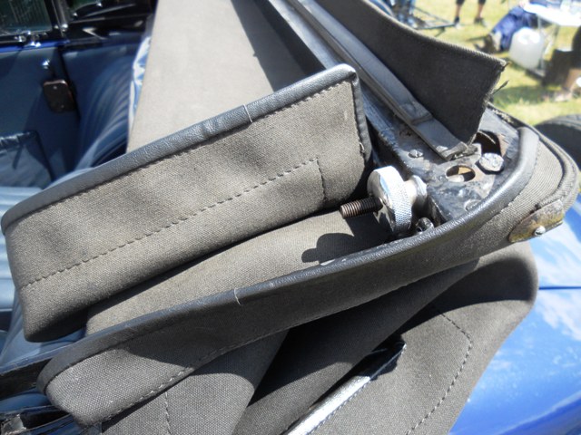

Pictures of hood latch and windscreen spigot on 10/4 tourer. These are 2-seaters but 4-seat tourers are same.
In essence there are spigots (or rounded spikes) at each end of the top of the screen which fits into a hole in the front stretching bar of the hood. There is a half moon cut out in each of these spikes into which a bolt is pulled and held tight by screwing up the knurled knob. The frame needs to be held down against the pressure of the top windscreen weather seal. To stop the knob dropping off the thread is burred over.
