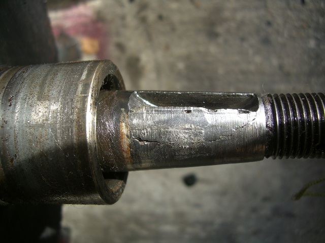

The Woodruff key merely locates the hub. It should not take the drive which should be taken through the taper. If the hub becomes loose on the shaft such that the drive and overrun is taken thru' the key then the keyway slot in the half-shaft will be subject to repeated on-off loading that will result in metal fatigue cracks and breakage of the end of the half-shaft.
Picture showing cracks on keyway is not mine but by another member

Also Peter W, that pic looks more like a repair gone wrong to me. It looks more like someone has run a weld down the side of the damaged keyway and the weld blob has broken out in the transition area between the weld material and the parent axle. Either way, not a good look.

You might well be right about the attempt at a repair with weld. It is not my photo, I "borrowed" it from another member without acknowledgement
